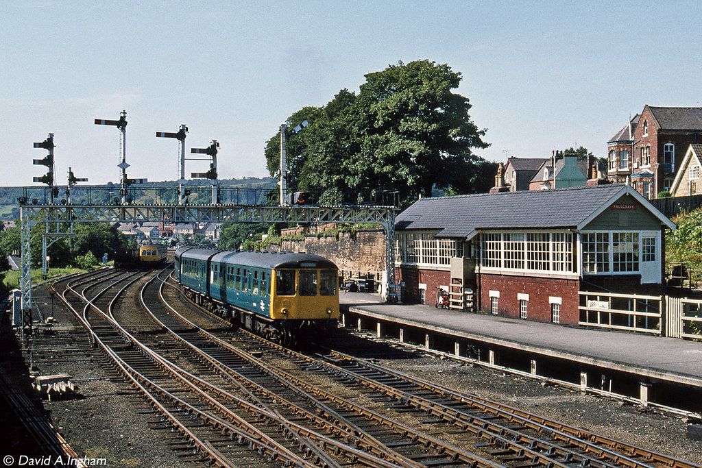

Here's one at Scarborough showing a route for C road.

Appears to be Scarborough in 1981 :).
Pure guess that it was put in when a "Scarborough Station" box was closed - but I don't know the history. Or perhaps it replaced an older indicator.
