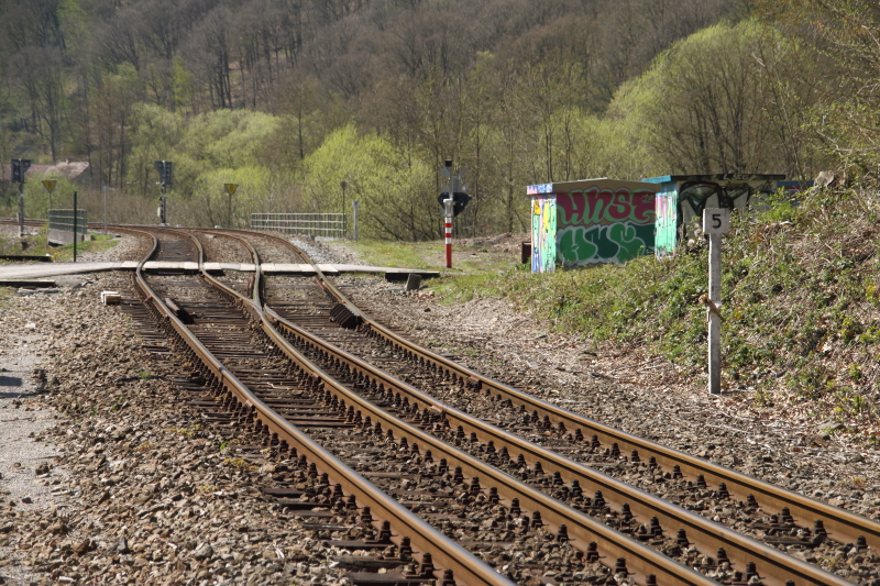

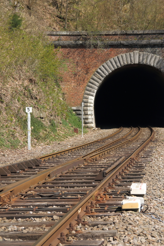

This summer, the last gauntlet track on the Belgian network will be replaced by two switches. It is used to pass the tunnel south of Jamioulx station, on the Charleroi - Couvin line. In the past, there were at least to other places in Belgium where a gauntlet track could be found:
- the tunnel between Statte and Huy on the Liège - Namur line, replaced by a larger tunnel in 1970
- the tunnel between Geraardsbergen and Viane-Moerbeke, replaced by switsches in 2013.
The pictures were taken on 18-04-2019.

Very interesting - I think. Please explain 'gauntlet track' :s
I think the pictures explain it...there are two separate tracks, but you couldn't run trains in both directions at the same time as the tracks overlap, one of the rails fitting inside the others track - like a glove/gauntlet - I remember an Amsterdam tram route in a narrow street set up like this, with true double track passing places on the slightly wider bridges. I suppose it avoids the need for moving parts that conventional points have, and no risk of routing on to the wrong track in passing places

Well, one learns still something new, though not every day anymore. I thought it was ''intertwined'' track or so in english.
And yes-here in AMS the trams (Leidsestraat and Utrechtsestraat) still have that-it also avoids the need for systems that set the points in the right direction, plus moving parts always run out much faster as fixed track. So a bit strange that the southerly neighbours do not want to have it.
A variation on this is when 2 gauge-widths combine, f.e. Fr-ES: 1 rail is used for both and the other side has 2 rails to fit the relative distance. it cannot be done for Russia, as there the difference in width is too small with normal gauge. But then again its probably not called gauntlet then in english, I guss?

I thought that they were called 'interlaced' tracks. 'Gauntlet' sounds like a nickname.

Wikipedia says gauntlet or interlaced.

Dutchflyer is right re different gauges sharing the same route - I think we would simply say mixed or dual (or triple!) gauge. Gauntlet/interlaced is more typically used where double track is involved, as in the Belgian example, and I think is much more common on tramways (is there yet another term for the very elongated pointwork in Croydon?).
There still is the Gemmenicher Tunnel, though. While that one is actually double tracked, one of the running lines has an additional set of interlaced rails shifted towards the middle of the tunnel for trains exceeding the normal loading gauge.
The third track inside the Gemmenicher tunnel is not really a gauntled track as it still involves some switches.
