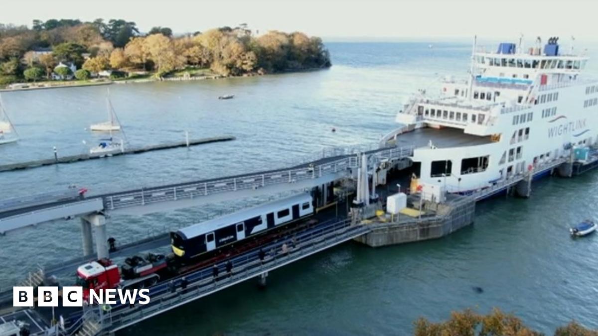

With regard to the works on the Isle of Wight, there is surely another cost factor to bear in mind, namely the need to transport the specialised permanent way equipment over to the island by ferry in a timely fashion. It is not as if it can simply be wheeled out of a convenient siding nearby when required.
