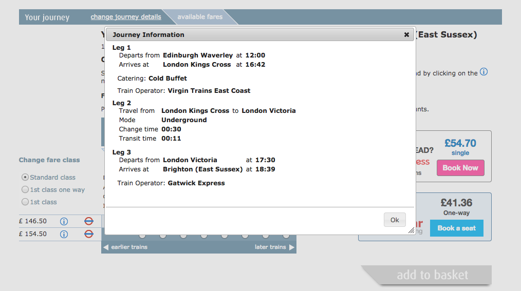

Hi
I was on raileasy searching for fares between York and Brighton. Its journey planner suggested YRK to KGX then the tube between KGX & VIC and then train again VIC to BTN. For the tube part it said:
Change time 30 mins (presumably 15mins interchange time for KGX, 15 for VIC)
11 mins transit time
or 41mins in total
Now I understand these times are in the timetable data including the 11mins tube time. My question is: are these legal minimums? i.e if I had a through ticket that included tube would it be invalid if the itinerary gave less than 41 mins between getting off at KGX and boarding the next train at VIC.
My interest was further piqued when I saw that NRE had variable times, e.g in the evenings 11mins became 16mins but also it has "Allow less time to transfer through London" tick box....

Can't we utilise the sum of the published fixed links and minimum connection times?
Minimum connection time is 15 minutes at both King's Cross and Victoria. According to brtimes.com the fixed links for King's Cross to Victoria is:
TRANSFER From 0001 until 0529 21 minutes
TUBE From 0529 until 0659 16 minutes
TUBE From 0700 until 1900 11 minutes
TUBE From 1901 until 2359 16 minutes
So 41 minutes is seemingly the valid minimum in between 0700 - 1900, just as the original poster found in the itinerary given.
