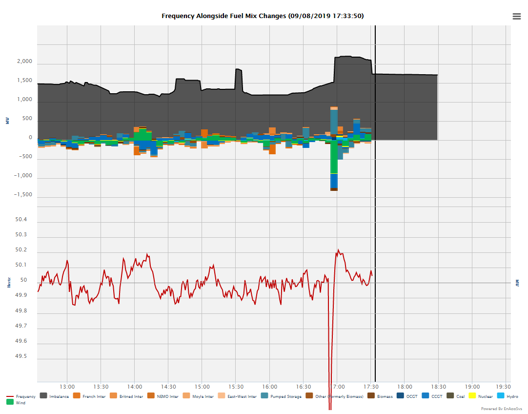

950MW of wind disappeared, as well as around 500MW of gas and solar each according to gridwatch. Thats 2 GW of loss in a few minutes. That's fairly substantial. It also happened at roughly peak demand, meaning there was a lot less spare capacity in the system as backup.
2GW of loss is somewhat worrying because a single large PWR like the ones at Hinkly Point C is ~1600MWe......

Is anyone able to confirm if it was specifically the frequency swing that caused the 700 failure, or whether it was merely the fact that power was lost for a time?
29,194
That’s not been confirmed, publicly or otherwise.

As far as I can deduce, based on the discussion so far, it was not as simple as a train losing power.
This event was unusual in that the loss of generating capacity in the National Grid caused the mains frequency to drop to around 48.9Hz or below. This is well outside the allowed/agreed tolerance. This triggered some controlled power disconnections in some parts of the country but as far as I know, traction current on main lines was affected only briefly, if at all. There were some signalling problems but only temporary ones.
Most trains carried on running. DC lines were unaffected. Most trains on the ECML and MML would not have been affected by this power disturbance, other than getting stuck behind those that were affected.
Speculation so far is that the initial drop in mains frequency may have caused the computer on board the newer 700 and 717 units to interpret this as a far more serious fault, which was difficult for the driver to recover from with a normal reset procedure.
If this is the case, then the manufacturers will learn from it and update the software to tolerate this scenario. I'm guessing that it's not something they tested as they did not think it would happen.
A computer is only as good as the people who programmed it and those who specified the requirements!
If this is the reason, and it's still to be confirmed, there will be a battle between National Grid (who should not have allowed the mains frequency to drop so low) and Siemens (who should have programmed the trains to be more tolerant).
There was probably no requirement for them to make the trains more tolerant. No doubt they designed the software to a rigorous specification - no more, no less - so that if there were a change in requirements, they could make more money out of us.
However, I presume all AC traction is synchronised with the Grid (I'm sure someone will correct me if I'm wrong). If that's the case, it's interesting that the Bombardier 710s, despite all their earlier software problems, carried on running throughout this event.
