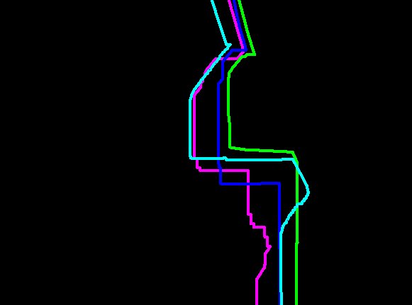

Someone mentioned that Mk4s have used the MML so I would assume clearance issues would be limited to the newer stations like St Pancras and EM Parkway. You're likely to need similar mods anyway to allow a build of 80x to use the MML, so the mods would be required anyway for the long term.
With regards to the gauge clearance, the example that I saw* which showed a Mk4 vehicle fouling a platform is described as a being on a "fairly tight but fast left-handed curve" and also implies that it is a 'legacy' platform. I can only assume that the Mk4's previous excursions on the MML haven't been at 125mph, and have thus had a reduced Kinematic Envelope. Also worth pointing out that the IEP is more similar to the Mk3 in the problematic step area than the Mk4, but as noted, these would have to be properly cleared (ie none of the theoretical negative clearance for Mk3s that is currently accepted)
Image 1: The platform (white) on a "fairly tight but fast left-handed curve" with the standard coper (red), and kinematic envelopes of Mk4 (Magenta), Mk3 (Blue) and Meridian (Orange)
Image 2: Detail of the Kinematic Envelopes for Mk4 (Magenta), Mk3 (Blue), Mk5 (Cyan), and IET (Green) on straight track at 25mph.
*Well worth reading through the rest of that thread, which is all about physical route clearing Mk4s on the MML from someone in the know
Fantastic post and very interesting. Thank you!
Very interesting stuff! A question though. It appears to be suggested that this platform in question is on the MML. What I find odd is that it appears that a Mk3 would also be out of gauge at said platform, which if it is on the MML seems a bit strange.
As Gareth explains "The trouble with the MML is that it already runs many of its platforms "foul", i.e. with theoretical negative clearances. This is a tolerable risk with existing stock experience but as soon as you introduce new stock, any corrections would have to eliminate "fouls" to everything."
So yes, theoretically the Mk3s should be coming into contact with said platform on a frequent basis, but you can point to the fact that they aren't to prove that it is fine to keep running them over the route. The Mk4s, being "Really Foul" will probably still hit it, even if the Mk3s aren't, but also modern standards mean that you can't get away with theoretical negative clearances.
Now that is interesting.
