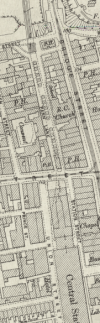

I assume the ones in Sunderland were necessary for construction? Looking on old maps - there seem to have been 16 at one point! (2 groups of 5, plus 1 group of 6).
