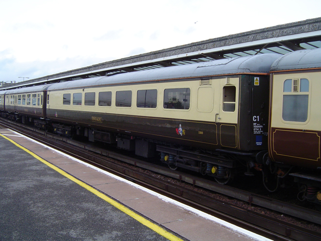

There were a couple of experimental coaches converted from TSOs in the late 1970s, notably RSS M1800 (formerly M5970), which was, as edwin_m says, to test ideas for APT catering cars. I remember seeing M1800 in service once at Carlisle in about 1978. It was later sold to NIR and rebogied for use on the Enterprise between Belfast and Dublin as No 546, before being returned to the UK and regauged again to become part of West Coast Railways' fleet as 1800 Tintagel. Pic here http://www.railtourinfo.co.uk/images/Coaches/1800weymouth290706.jpg
Couple of pics of it in InterCity guise at the top of the page here with a mention of the other short-lived conversion http://www.eastbank.org.uk/br_coaches.htm
