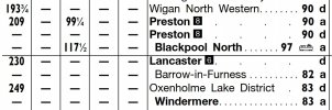

There's a very good chance that it's me that is at fault here, but I was hoping someone could shed some light on a possible irregularity within Railmiles.
I've come across some interesting mileages when using the Metrolink in Manchester, but assumed it was as a result of it being light rail. However, I've come across a potential issue when travelling between Wigan and Kendal.
The input of today's 12:18 journey ,returns a distance of 44m 41ch. A mileage engine query returns a distance of 57m 24ch. And whilst only as far as Oxenholme, the National Rail Timetable seems to agree with the higher milage.
Would I be right in thinking that there's an error with the Railmiles calculation, and that it is the higher 57m 24ch distance?
Thanks

Many large stations give you several identical options on the dropdown list when entering them into Railmiles. The different options appear to be different platforms/sections of the station, but there is no indication of which is which (different codes but no explanation). As a consequence, you can get some stupid results, for instance if you chose Clapham Junction to East Croydon and pick the option that is the lower numbered platforms at CJ you'll get a silly route (but it will be the shortest possible from the 'wrong' platform). You always need to check the route and if it's wrong pick another option from the dropdown list.
ps It also gives the shortest route from the options you put in. If this involves a reversal it will give you a route that involves reversing at a junction. And mileages via York will take you round the avoider unless you're heading up the Scarborough line. Similarly, in my neck of the woods it will give mileages via the Rhubarb in Bristol if avoiding TM is the shorter route.
pps Wigan-Kendal is indeed 57 and a bit miles. Railmiles gives me 57m 24c
It's a glitch relating to the signal at Oxenholme, and it has now been fixed. 57 and a bit miles is the correct distance.
