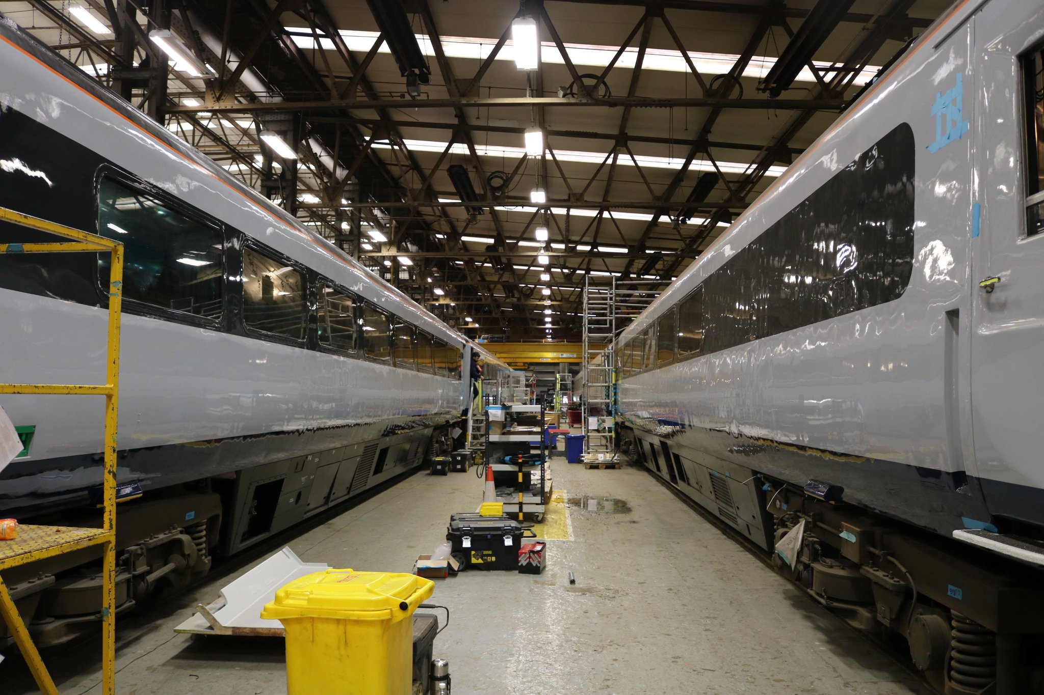

From Scotrail Twitter so presumably in the public domain; https://twitter.com/ScotRail?ref_src=twsrc^google|twcamp^serp|twgr^author
D2Pl_eYWoAAQ-T3.jpg:large
D2PldyzW0AAqc2E.jpg:large
and;
D2PlNryWsAAHYI1.jpg:large
I have just noticed in the top photo Mk3 on the right is a TGS so that should be the first 5 coach set then.
43096
23 Nov 2015
15,268
That's the TGS not TFB. As the slam door would be on the other end.
There are no TGS vehicles in the refurbished ScotRail sets. The slam door is retained at the buffet end of the TFBs, which is exactly what is shown in the photo.
Not a TGS, it's the TGFB. ScotRail aren't using any TGS vehicles in refurbished sets. The 5-car will have an extra TSL.
It looks like a TGS as there is still a handle on the outside.
It's the crew access door or equivalent. It won't be used by passengers (in common with Mk3 buffet cars), so no point making it a sliding door.
Also the guard's door on TGS vehicles has a second, smaller door next to the main one:
How many times? IT IS NOT A TGS. Why?
- no TGS vehicles in the refurb fleet for ScotRail
- no additional opening for the door as on a TGS
- window arrangement different to a TGS

Regarding the emergency slam doors beside the buffet I don't remember seeing the in service ones with outside handles,perhaps this mod is left to last minute to allow access via that door while the work continues.
I'll add in that there are NO TGS vehicles on the refurbished Scotrail sets! The (power) doors will be operated just like any other DMU/EMU. The door control panels are, in fact, designed to mimic those of a 170, for ease of training.
As others have explained several times, the remaining slam door is a crew emergency exit. If it was for passenger use, it would be painted the contrasting blue colour, not the bodyside grey colour

One reason I thought it was but as you said it isn't millions of times now. Is that I couldn't any yellow stripe on the top but they are not quit finished as I now realised. That Mk3 could but I maybe wrong on this looks as though it's the wrong way round in the photo. As someone has already stated the outside jangle arrangement must be a recent to have been kept as the first set doesn't have the outside handle on it.
Thanks for clearing that up though Chief ;)
