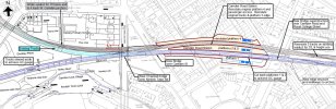

It reduces Euston cost by billions. Its also half the cost of tunnelling from Primrose Hill to Euston.
1) The existing viaduct around Camden market is already 8.4m wide so it’s wide enough for a pair of GC gauge tracks. The work is just to replace bridge superstructures @ about £8 million each for 6 bridges ( Whaley bridge just got new superstructure for £5.1m ).
2) Redecking existing bridges and restoring tracks on existing railway land for 1km of 4 tracking for TfL track isn’t a vast task - say £30m. Plus £10m to restore the old platforms at Camden Town?
Remember that TfL save £1 billion by avoiding needing to upgrade Euston underground because if most HS2 trains go to St Pancras instead of Euston, Kings X / St P already has an upgraded and perfectly big enough tube station to cope with HS2 traffic too.
HS2 save £5 billion by avoiding the need of ever having more than about 3 platforms for HS2 at Euston - which could be postponed until it reaches Manchester and which could be approached via the existing throat from Primrose Hill instead of an expensive tunnel between Primrose Hill and Euston.
The Euston rebuild could be postponed until HS2 reaches Manchester and until the rest of Euston needs to be rebuilt and Crossrail 2 gets built.
Meanwhile by overlapping Javelins to OOC ( ideally to Heathrow ) with all HS2 trains sent via St Pancras reversals to terminate at Stratford , Ebbsfleet and Ashford, we get 12 tph across London and HS1 platforms can terminate up to 11 HS2 trains per hour.AlternativeSolution.jpgCurrentCosts.jpgPrimroseHill-Junction.jpgWhy is St Pancras better than Euston.jpgNNL-4tracking-on-existing-railway-land.jpgOption1.jpgUsingExistingCapacity-1.jpg

Connecting HS2 services to the Thameslink, Javelin, Great Eastern and Kings x networks plus running through services to Stratford and Kent UPGRADES and INCREASES revenue to repay costs sooner.
Using EXISTING north London line links and EXISTING poorly used platforms at St Pancras ( for reversals ) and 6 completely unused HS1 platforms ( at Stratford , Ebbsfleet and Ashford ) for terminations SAVES £6 billion at Euston.
If you look at Arup’s drawings, using the NNL is totally feasible.
Redecking or replacing road bridge superstructure.
Restoring 4 tracking & still existing Camden Rd platforms.
Cheaper than even the section of tunnel saved to Euston.
40mph is fine for trains slowing to approach St Pancras platforms.
Overlapping Javelins sent west to OOC with HS2 trains sent east via St Pancras reversals to Stratford or Kent adds at least 12 trains per hour ACROSS London to connect up networks.
That doesn’t just add passengers to HS2.
The Elizabeth line can’t cope with demand.
It adds capacity for links to the GWR at OOC.
A ramp there to the GWR could enable Javelins to become the new Heathrow express to free up GWR platforms at Paddington too.
Overlap Javelins with HS2 trains to bypass London for millions.
They’d stay on board to reduce the need of city centre platforms.PrimroseHill.jpgCamdenMarket-NNL.jpgCamdenRoadStation.jpgStPancras-Junctionwork.jpgAlternativeSolution.jpgPrimroseHill-Junction.jpg
