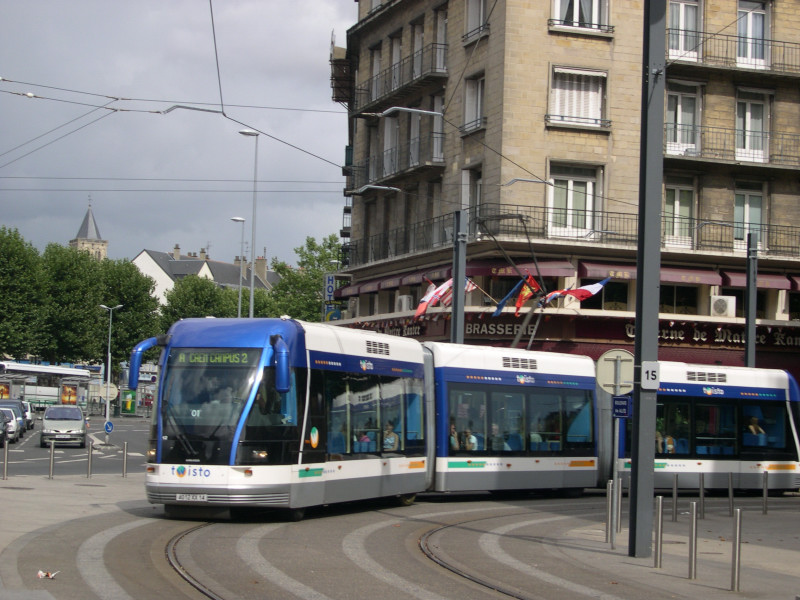

The French found that happened with rubber tyred trams* in Nancy and Caen
*They are guided trolleybuses

The Caen system of Guided Light Transit is of course being replaced by Light Rail by 2018. In fact Bombardier are no longer promoting this form of urban guided transit.

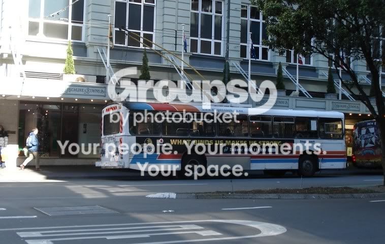

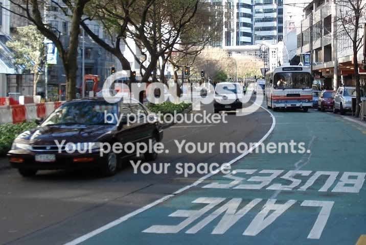

Why not? Last Trolley buses I went on was in Wellington and they shared all routes with traffic and I never encountered any problems with them. Even going up some of the massive hills behind one of them.
No technical reason, more from a bus priority viewpoint, its better to keep the service out of traffic (either dedicated RoW or Bus lanes) so it doesn't get jammed in traffic!
