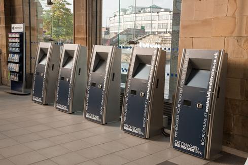

Are the TVMs in Sheffield next to a wall? If they are could some sort of enclosure be built around them with an extractor fan to extract hot hair from within the enclosure?
They're set against a glass window in the station building looking out towards Sheaf Square.
https://www.transportxtra.com/files/10662-l.jpg
I'm not all too familiar with TVM systems at this time, but of they break down too frequently, surely a Raspberry Pi (or any similar SoC) would be enough?
