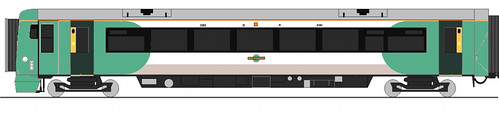

I modified the diagram on the Class 377 page on Wikipedia on Paint yesterday and came up with this.

Regarding the PTI (Platform Train Interface) the track needs to be lowered at alot of stations like Clapham Junction. Probably better in the long run than to install 'gap bridgers' to trains.
Nice one. Tweaked it a bit so that there is standback space on either side of the doors. Not sure I like it in the Southern livery though.
Gap bridges are the only effective way of dealing with curved platforms. They could probably pay for themselves on a busy route, with shorter station dwell times and less accidents.

Wheels look a bit small on that sketch. By my rough scaling, the height of the unit is 3.68m (from the internet), the wheel diameter fits that height a shade over 5 times. Call it 5.1. That means the wheel diameter as drawn is ~720mm. I'm used to wheel diameters of 930 to 1050mm so that figure seems on the small side to me. Hey, it's only a representation so it's not a big deal no. They just look too small to me.
The livery looks nice on it! The passenger door closest to the cab door was set back as far as it is in my original so the cab door would open without obstructing the passenger doorway.
I thought by lowering the track the silver coloured steps on the doors would effectively bridge the majority of the gap?
There are two components to step distance. The vertical difference and the horizontal distance. The former can sometimes be adjusted to give the correct standard hight which I think is 915 above rail level. Some London Overground stations have higher platforms level with the floor of the vehicles. Where platforms are curved there is a wider gap. The closer to the bogies the doorways are, the less the difference. Class 158 are better than Turbostars which can have big gaps at concave platform faces. Electrostars are better generally than classes 455/317 and similar types. There is also the effect of superelevation on curves. Some trains give rise to huge gaps on some locations in eg Clapham Junction eg platforms 13 at the London end and platform 17. There are some big gaps at certain London underground stations, hence "Mind the Gap", as these were built when vehicles were about half the length. I am surprised that the S stock was built without extending steps, at least those for the Circle and District lines. The gaps are a hazard in some places.
The problem with extending steps is that its abit unpractical, it would take a ages for doors to open at stations
Um, platforms curve both ways. What you say is correct for a concave platform face, but on a convex platform face the closer to the centre of the carriage the closer to the platform the doors are.
There's other factors too- carriage end doors, even if they;re wide, are ineffecient for loading/unloading compared to ¼/¾ door position
Yes and no. If the doors are directly above the bogie centre pivots (as seen in some DD stock where you have high platforms) then they do not swing either way. However, that's not a very convenient place for them, unless you have extra-big toilets or luggage racks in the ends of the coaches and the saloon between the doors, which might work on Voyagers, but at one end only. Otherwise, you would have to cram a small passenger compartment into there to avoid losing seats. It works on DD stock, because that can be for wheelchairs, prams and so on, but not on SD stock, because it ends up as a bit of a waste of space.
As you say, the ¼/¾ position is much more practical for suburban stock, while inter-city stock suits end doors.
This keeps being said but where is the evidence? All end door vehicles have restricted vestibule space and a pinch point at the entrance to the saloon. There is no possibility of making like-for-like comparisons with UK stock.
Stock such as the class 313 in its original form was glacially slow due to the lack of standback space. Most plug door stock has an awkward step.
The optimum place for doors for minimising the effects of platform curvature in either direction is over the bogies.
They don't swing, but the centre of the coach does- thus the track has to be further from the platform than if it was a straight platform, creating a gap.
Not quite like that either. Have a look at the C1 loading gauge diagram. You will see that it cuts in at platform level and below. On a convex platform the end doors will be further from the platform edge than if the platform is straight. On a concave platform the vehicle cuts off a chord between the bogie centres which follow the line of the track itself, leading to a wider gap.
At the bogie centres the gap is going to be unaffacted by curvature.
1/4:3/4 doors results in two small compartments typically about 4 metres long where the options for seat layouts are restricted normally to 4 rows of seats. In longer saloons seats can be fitted in at different pitches to achieve the desired seating density - possibly too many for comfort.
The step takes at most five seconds to deploy before the doors can be opened and after they are shut, more likely three seconds to open and a second to shut. Four seconds is not ages. If it means people get on and off the train faster then they would otherwise do then that is time saved.
