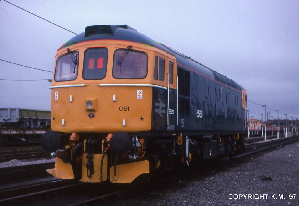

The first question is a little obscure but I was wondering if anyone knows the purpose of the four bolts in the middle of the front panel that you can see in this photo:

The 4 bolt holes might have been for attaching a step like the ones on the class 71.

It's the only thing I can think of. There was a 33/0 that got a new front in the late 80s/early 90s. I will try to find out which loco it was as it would be interesting to see if the bolts are there.

Anyway, I found a pic of the 33051 after it got a new front end.. and the 4 bolts are missing. My theory about a step that was never fitted may be right!
I wonder if the headlight has been fitted over where the 4 bolts were? It certainly appears to be in the same position so it could be the bolts are still there just hidden now by the headlight?

always wondered if the 4 bolts on the front were for some internal fittings
Other photos show the headlight above the bolts - presumably on the other end.

The bolts in the picture in the first post look like they are holding something in place on the inside of the bodywork to me.

Might they have been some form of headboard / nameboard mounting bracket, later removed? Anybody got access to phots of 33s working named trains on the Southern?

I thought that also but having seen a 33 on the Night Ferry, it was not for a headboard.
My best guess is a step so crews to reach the centre windscreen/headcode. Like the 71.

Looking at that 71, I think you're right. The spacing of the bolts on the step is the same.
Incidentally, anyone know what the four hooks are for?

Oil lamps. Different positions told a signal man which train it was. Not an expert on this but buy the position of the lamps, a signalman would know if it was a fast passenger or slow goods.

The lower ones are tail lamp brackets*, clearly, but the upper ones don't correspond to the conventional placing for headlamps - they wouldn't have been needed on the Southern anyway.
(*the Railway Inspectorate hadn't approved electrically powered tail lamps or red blinds back in 1960)
PG
3,241
I'm purely guessing but if the upper ones weren't lamp brackets would they have been for nameboards?

That makes sense, as the 71s had the same, and the SR used rectangular boards for the Arrow and Ferry.
