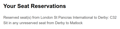

There is availability on the first service for ticket type 2DS, but not the latter service. Indeed, it doesn't even exist in RARS:
Error: E00202 No inventory found with Retail Service ID EM5338 on 11/07/2023
I am not convinced the fare should be being sold under these conditions. The second timetabled service is "Reservations available from Derby". Given it is an Advance, surely a reservation must be made on every timetabled EMR leg?
If I actually try and buy it; traintickets.com displays it but prevents me from adding it into the basket:
traintickets.com refuses to allow the tickets to be purchased
On raileasy.co.uk, I am actually mis-sold and fulfilled a ToD booking without a reservation on the second leg:
Extract from confirmation email showing no seat reserved from DBY -> MAT
My view is that Railsmartr are mis-selling here, too (i.e. not just Atomised)
Railsmartr booking confirmation
The restriction code is quite clear that seat reservations are mandatory. Railsmartr appears to misleadingly imply a counted place reservation has been secured, which I have verified would have been impossible given how EM5338 has been configured in RARS.
Seat reservations are compulsory for the restriciton code associated with this Advance ticket.
TrainSplit does it properly and does not sell the Advance fare given the absence of availability on the second leg.
Trainline is correct to split and not to try and sell the Advance past Derby.

Is the Matlock train normally reservable?
Timetable data says it is.
The answer in terms of what's actually set-up in RARS would suggest it's not set-up to dish out reservations for all of the dates/times I've tried so far (for this ticket type, or a walk-up). It's unclear if EMR have done this intentionally. Retailers have next-to-no visibility of S3P though, so *shrug*. TOCs are just left to do whatever they want, as far as I can tell, and it's a black box for other industry participants.
Note also that the route is not an "& connections" route. The route IDMS text is "Only valid on booked East Midlands Railway services" / "Specified East Midlands Railway only".

I have now experimented with trying to make reservations on Derby-Matlock trains (and vv) using the GWR bookings system. After choosing a train and ticket type, the problem trains offer a choice of Reserve a Seat and Reserve a Bike Space. If you opt for Reserve a Seat, then it invariably says "Seat reservation(s) have not been possible for your chosen service."
Other trains offer only "Reserve a Bike Space" - and these ones generally have Advance availability.
From the replies above, I am presuming that EMR have erroneously listed most of the services in the Derby-Matlock direction (all except the first two services of the day?) as needing reservations, but have then failed to specify any number of places available. I have never encountered proper seat reservations from Matlock in the last 30 years - but can't be sure that they didn't impose "counted places" reservations for some of the Covid period.

Adam is correct here - the Nottingham to Matlock service is reservable only from Derby to Matlock, and this should cause an Advance fare to not be offered for the itinerary the OP wants, as the Nottingham to Matlock service is not set up in RARS2 (the reservation system).
The change of reservation status (from "null" to "possible") at Derby is not being recognised, causing the issue. It's fairly unusual for reservation status to change midway through a journey - are there other examples?
This can be fixed, of course.
