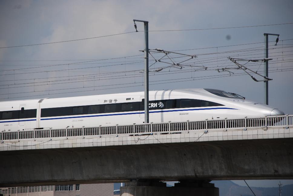

Any ideas what the train on the left is? Not see that before.
15 Jul 2007
90
Canada
bcat
19 Apr 2008
14
The train on the left is CRH1E, currently serves Beijing-Shanghai over night route and perhaps some other routes. The train on the right is a later version of CRH2, should not be a CRH2A, but it is not easy to figure out which type of CRH2 it is from the angle.

Breaking News! the first CRH380B, CRH380B-6401L (L means 16 cars train), completed at CNR Tangshan factory by september 21 !
this picture made a mistake on train number, on the following video we can see the train number is CRH380B-6401L
here is a 12 minutes Video for the Official ceromony
http://v.youku.com/v_show/id_XMjA4MDM0MTY4.html
Official name of CRH 380 series confirmed by this thread
http://www.hobbyshanghai.com.cn/viewthread.php?tid=35077&page=1
CRH380A, train No. 6001-6140 (140 trains in total) manufactuer by CSR Sifang Factory, 7 trains completed by september 26
CRH380B, train No.6201-6310 (110 train in total) manufacturer by CNR Changchun Factory
CRH380B, train No.6401-6470 (70 trains in total)manufacturer by CNR Tangshan Factory, 3 trains completed by September 21
CRH380C, train No.6601-6680 (80 trains in total)manufacturer by BST
September 24, CRH380A-6002 test run at Yuyao station, Huhang PDL
