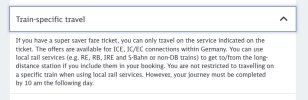

Can anyone clarify what the rules are with a Super Sparpreis Europa ticket - are they essentially the same as for Super Sparpreis, here -
I am looking at a journey with multiple legs, starting in the Netherlands (sequence of RE & Dutch IC trains) then a couple of DB RE & S-bahn, then the DB IC, then another RE at the end.
Basically it's the German IC train that is the one I have to travel on, is that right? The RE and S bahn ones, I just have to stick to the defined route?
Does anyone know if I am also restricted to the specific IC trains in the Netherlands or can I take earlier/later ones too, on the same route?
