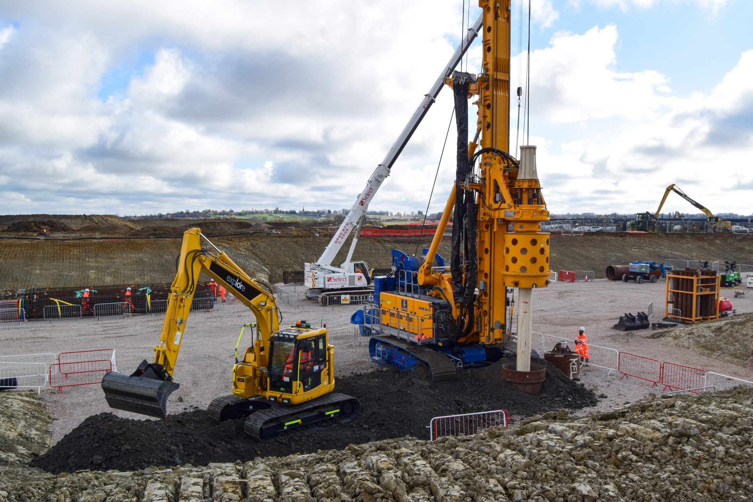

Article from New Civil Engineer. In summary:
HS2 contractors begin work on key East West Rail bridge
Contractors working on High Speed 2 (HS2) have begun construction of a key bridge where the East West Rail line will cross the high speed rail route in Calvert, Buckinghamshire.
Excellent integration of two vastly different projects!
