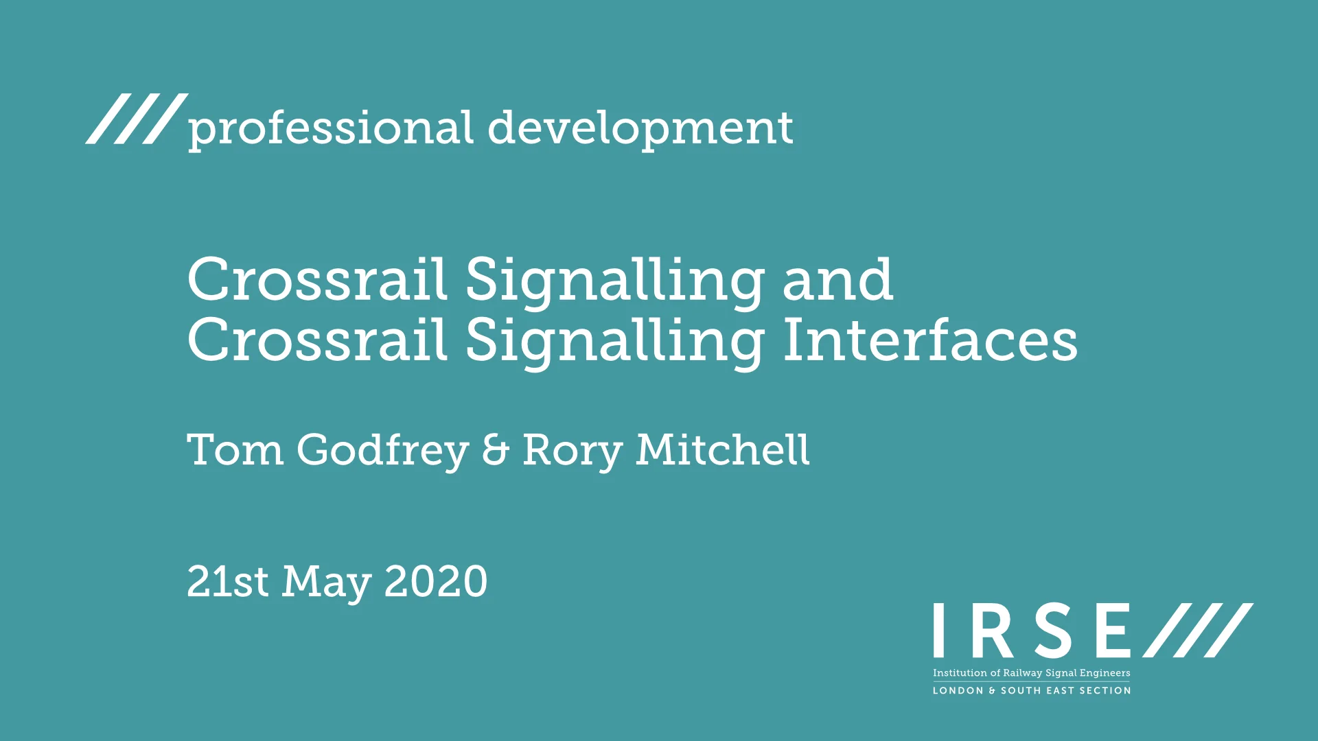

I saw this video presentation recently which includes details of how the 345s switch from TPWS to ECTS when or vice versa on the line at Airport Junction. (At 16:44 in the video.)
Interesting to note that because they thought it might take longer to switch and obtain a good GSM-R signal they actually switch to ECTS Level 1 before switching to ETCS Level 2.
