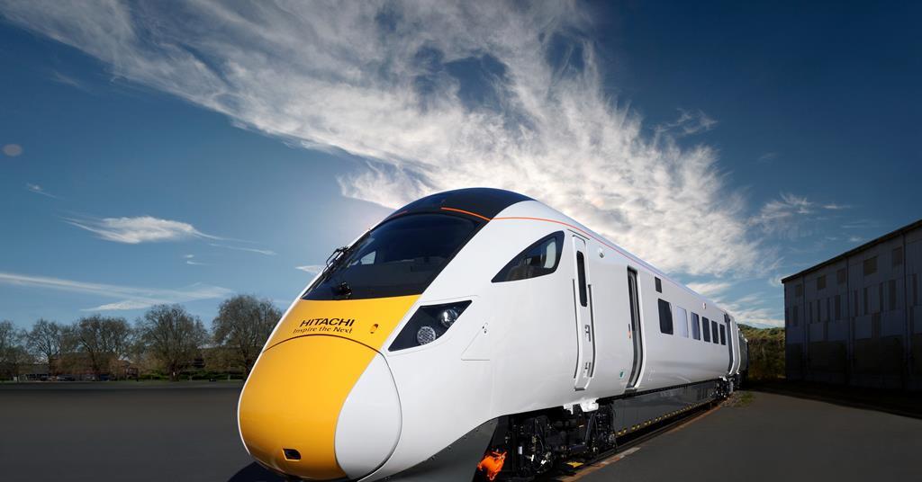

This thread is to discuss news and developments of the Hitachi battery intercity train for the UK market, which I understand is being developed by replacing one diesel pack on an 802. So I suggest we call it the 802B, until we get a more official name.
Here is the Turntide press release ...
These trains can switch seamlessly between diesel power, overhead electric power, or battery power. They can run on battery power alone, effectively bridging between electrified stretches of track or when entering/existing stations.
... and case study (pdf)
Solution design The partnership produced a high-performance rail application battery pack of 16 batteries with nominal system voltage over 2500V, designed to last four years on arduous routes or up to 15 years on lighter routes. This modular solution is ideal for retrofitting existing trains and avoiding extensive reengineering or rebuilding of the entire train.
The modular design of the battery technology is ideal for retrofits of existing trains and can be used to replace diesel engines without reengineering or rebuilding them. This means minimal disruption to service since trains can be updated and returned to service quickly.
The battery will enable the train to run up to 90km on battery power and to recharge via overhead wires while in motion. The hybrid trains can enter and leave stations in battery mode, reducing diesel emissions and providing a quieter environment with improved air quality.
