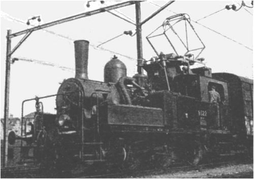

You could have quad-mode trains with diesel and 750V, 1,500V (to run on the Tyne and Wear Metro), and 25kV. Or replace the conductor rail with silver - it is a better conductor.
I thought you didn't like more-than-one-mode trains? That would probably cause more trouble integrating it into designs than it's worth, and the weight... Do I need to say more?
Sorry I forgot to mention they could run on LPG and coal as well.
So basically a fleet of these...

Damn, I can't seem to avoid that there picture!
@RAGNARØKR: Sarcastic or not, you're contradicting yourself...
