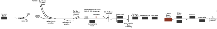

For those struggling to visualise the layout, here’s a diagram showing the Avonmouth area.
Please note, not all sidings and points shown for the freight lines.
