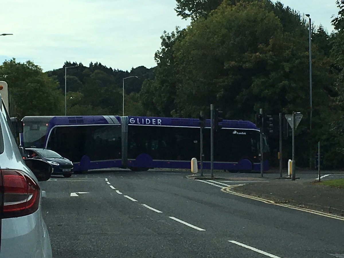

Who would have guessed a bendy buss would would have issues:
Lots of complaints about it being slower, fewer seats and just crap.
https://twitter.com/TrafficwatchNI/status/1044196171579887616
#Dundonald Glider Bus Stuck East Link Road / Comber Road!

How are they different from a ‘normal’ bendy bus, apart from styling?
Jordan Adam
12 Sep 2017
5,610
Aberdeen
The biggest difference with these and the Streetcars is that the front axle is set considerably further forward than on the likes of the Wright Eclipse Fusion bodied Volvo B7LAs and Mercedes Citaros. Because of this the wheelbase between the front and centre axle is much longer, this means the turning radius is quite noticeably inferior. Believe it or not the B7LAs actually have a much better turning radius than the likes of the B7L and B7RLE. This is simply due to the distance between the front and centre axle being much shorter.
Another thing that sets them apart is all the extra bodywork, the Streetcars (which were on a modified Volvo B7LA chassis), were known for being very slow, this is due to the extra weight from the body. Where as the standard Wright Eclipse Fusion bodied Volvo B7LAs are capable of some quite impressive acceleration and hill climbing.

DTOS A or B
Dont understand why the driver has not straightened it up and tried again, unless something else is wrong.
Jordan Adam
12 Sep 2017
5,610
Aberdeen
It appears to have jackknifed and the automatic brake has applied to stop the bus moving, preventing damage to the turntable. There is a brake release switch but part of the issue with them is that drivers are known to abuse it.
When driving normally if the button is pressed it "boosts" the engine making the bus accelerate faster. Certain drivers here have been known to wedge bits of paper in the button to hold it down when they've been running late. A consequence of doing this is that it can damage the turntable. As such if drivers are caught they get in trouble from management!
Because of this it really wouldn't shock if the Glider drivers have not been shown where the button is!
Of course another factor is the driver can't reverse the bus without a banksman.
