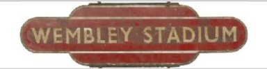

The West Country
Wembley Stadium station was a late recipient of totem signs. They were second hand Watford Junction ones that were then overpainted.
Not my photo.
