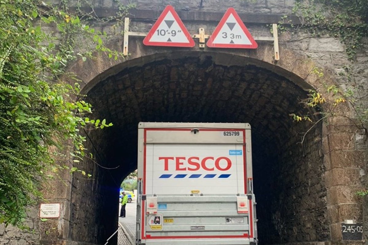

The prevalence of bridge strikes shows that existing arrangements, predominantly signs, don't work.
And drivers are people, so unreliable.
Is there no technology that would work- eg lasers, flashing lights, engine cutouts, solid steelwork like that which prevents campervans from some car parks, tech that works at level crossings with overhead electrics... lives are at stake

Engine cutouts would be just as dangerous - you don't want a car ending up under the truck - and would be problematic to install, especially at a location with varying clearances like this. Solid Steelwork is used where practical but it's not always sensible in each location. Lasers and flashing lights would presumably not have very much impact as people already miss the high-vis paintjobs and warning signs.
The cheapest solution over the life of the bridge is to replace it with one that meets clearance requirements. As has been done a little up the road on the Westbury-Salisbury line.

If you look on YouTube for the many videos of the "11ft 8in bridge", many of those measures have been tried, the bridge has been raised (by 8 inches, limited by the rail alignment), yet still trucks hit it.
These measures are effective, but not *completely* effective against inattentive or ignorant drivers.

Laser triggered warnings and solid steelwork both exist and bridges still get hit.
Check out the video where a driver ignores 2 clear warnings but is eventualy stopped by the water curtain.
FYI people still drive through the water curtain !

Does require a large volume of water though, which means coming up with a way to source it, store it and drain it. For a critical piece of infrastructure it's worth it, but for each and every brick arch bridge we have in this country?
I personally think more bridges should be fitted with the chain-and-bar things they have at the Blackwall tunnel. Cheap to fit and maintain yet robust enough to take multiple hits without replacement. Big enough to see and loud enough to let you know you should stop.

There are very many reasons it can happen. There is, for example, a bridge at the south end of Stoke-on-Trent station that is signed, correctly, as being 10' 4" high. But a 10' 3" lorry or bus won't fit under it, as there is a dip in the road so the length of the vehicle means it isn't at road height at the lowest point.
Conversely, at the North end of the station the bridge there was for many years signed as 13' 4" High but a 13' 8" double decker bus fitted under with room to spare! There was a historical reason for this. More recently the bridge was renewed and road realigned and all is now correct. As an interesting aside, in a novel twist British Rail once ran a locomotive over the top of the bridge and onto the road!

In your first example, the signage is incorrect.
The Department for Transport manual on road signs (https://assets.publishing.service.g...ile/772037/traffic-signs-manual-chapter-4.pdf) makes it clear that height and width restrictions are to be signed based on subtracting 3 inches from the most narrow point of the obstruction and then rounded down to the nearest 3 inches, so if a 10'3" vehicle won't fit then the sign should not display a height larger than 9'9".
The second example is also wrong, as whatever the actual headroom, you cannot round down to the nearest 3" and end up with a value ending in 4 !
