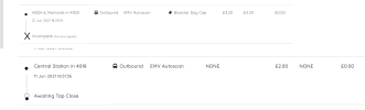

Go-Ahead group will charge you to the end of that route, no penalty or anything just instead of a destination on your history it says "awaiting tap close" Or "Incomplete" But not have any financial repercussions or addiontional fares charged and will still be included in any relevent cap that you had earned,
Uni-Link bus captains in southampton regularly would neglect to tell people how to tap off, as its a flat fare route, which is fine I guess until they start to use other routes, especially long distance ones :/
A Copy of an old statement of mine (from Go South Coast) Demonstrating what happens if/when you neglect to touch out using tap on tap off,

It's the only sensible approach. It provides a nudge for people to touch off, avoids the need for huge contact centres or complex AI to fix it, and avoids penalising people unnecessarily.
I don't know if they do, but conversely it makes sense to charge back to the start of the route if you didn't touch in but did touch out and weren't caught by an inspector.
TBH I don't entirely get why TfL has all the complexity of "unresolved journeys" and doesn't just charge a maximum single fare (or nothing, if the cap has been hit) if it happens with no option to fix unless there were mitigating circumstances like an evacuation. It must cost them a fortune in staff time.
