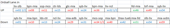

A new Liverpool to Manchester Timetable or: how I made a timetable guarantied to upset almost everyone.:D
Inspired by this thread I got to thinking about about changes to services if you just stopped using the Ordall chord for regular services.
So here's post Stalybridge electrification base hourly timetable for the Chat Moss, where I've rerouted two of the worse offenders for importing and exporting delays from the Castlefield corridor.
The Saltburn to Manchester Airport is rerouted to form a Saltburn to Liverpool Lime Street. Requires at least one extra unit to run.
The Liverpool to Manchester Airport stopped is now a Liverpool to Stalybridge stopper. 4 units for one train an hour 7 for two. I had to sacrifice the peak time Wigan via Chat Moss trains at both ends for the half-hourly service, but there would probably be some routed there at the start and end of the day for stock movement purposes.
Yeah so I've cut direct service to Manchester Airport for a "few" people...
Corresponding CLC Warrington timetable to come at some point.
Services from Liverpool stops marked in blue, from Chester in green and junctions with potential conflicts in red.
Anyway probably missed some obvious conflicting movement somewhere and I've not factored in freight runs currently, oh well enjoy;
Generalised timings for services at Ordsall Lane junction

Don't read too much into the Glasgow it's more just to illustrate the path of the one service that currently runs.
For the reason SuperNova states the Newcastle and Saltburn are on their current timings from Stalybridge onwards.
Same reason I couldn't have a nice 15 minute timings for the stoppers toward Lime Street, the timing for the Blackpool North from Wigan means it doesn't work anything that needs a change to the west coast mainline timetable is a non-starter.
