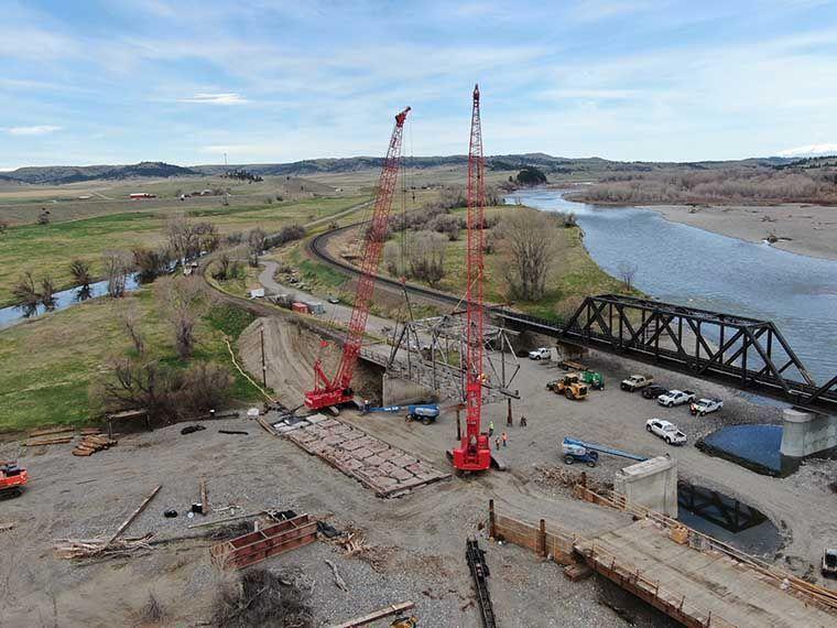

One of the midstream support pillars appears to have failed, dropping the steel trusses into the water. The river level looks quite high in the photos, which might be relevant.
stuving
26 Jan 2017
266
Some of the reports refer to the site as "Twin Bridges", and on Gogle Earth you can see the road and rail bridges next to each other. But the road bridge was removed two years ago (or else it would block some of those pictures). This is from Yellowstone Public Radio:
The concrete pier under the old Twin Bridges Road bridge has been so eroded by water and debris flow over the past 90 years that the Montana Department of Transportation determined it was in imminent danger of collapsing into the river and needed to be demolished.
You can see the piers of the rail bridge have had new bits of concrete to shore them up - but maybe that middle one needed a new foundation.
Here's a picture (from billingsgazette.com) of the road bridge being demolished, with the water down at its more usual level (and off the right side of this view. The peirs are in line with the railway bridge's, so you'd think digging one out might affect scour at the other, wouldn't you? Yet none of the reports I can find about the road bridge mentions the rail bridge having similar problems. Now the rail bridge is not the Montana Department of Transportation's responsibility, but still isn't that odd?
Construction crews remove a section of the failing Two Bridges Road bridge across the Yellowstone River east of Reed Point on April 3, 2021.
Further reporting from early 2021 at ktvq.com includes a video of both bridges at low water, and this:
REED POINT — The bridge over the Yellowstone River on Twin Bridges Road near Reed Point is under threat of collapse due to heavy scouring of the riverbed on a bridge pier in the river channel, said Stephanie Brandenberger, bridge engineer for Montana Department of Transportation, Wednesday.
"Over the years, the river has actually moved the material around that pier to the very bottom of the foundation, and in fact it is going underneath the foundation in some locations. There’s not a good foundation under that support for the bridge," Brandenberger said.
“We do want to try to get at least the portion of the bridge out that’s in the active channel of the river before high water. That’s when the most damage is going to continue to occur on that footing," Brandenberger said.
The bridge has five piers. Pier four, in the main river channel, has the most damage. Divers measured a three-foot-deep hole under the footing recently. Two other piers in the river channel are showing less severe scaling damage, Brandenberger said.

Looking at the earlier pictures, I reckon that the pier on the far side (the patched one) has tilted over and has a big crack right across it near the waterline. Some failure! But it still doesn't tells what the sequence of events was or the original cause.
Here's another recent report, from the Montana Free Press, which has this explanation of why MRL may still be responsible for the track as well as the train being theirs:
Railroad officials have not offered a timeline for how long it might take to clean up the site and reopen the rail line — a critical route for cargo to the Pacific Northwest — but it is likely to take weeks. While that happens, freight that normally traverses MRL lines will be diverted onto other routes, including BNSF Railway’s main line across the northern part of the state. MRL leases its track from Huntley (near Billings) to Sandpoint, Idaho, from BNSF. Last year, BNSF and MRL announced that they would terminate that lease early and that the larger BNSF railroad would once again take control of the route across southern Montana. (BNSF operates 32,500 miles of track in 28 states; MRL operates on about 900 miles of track in two states). Earlier this spring, federal regulators approved BNSF’s plan to resume control of the line and the deal is expected to be complete by the end of the year.
Depending on the terms of that lease, the question of whether the train derailed and broke the bridge or the bridge fell first might matter a lot to MRL.
