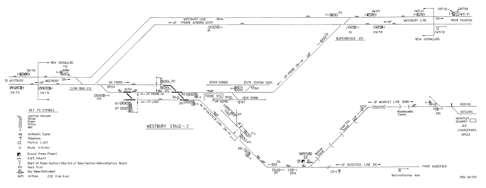

The two layouts shown here are informative: https://www.s-r-s.org.uk/html/gwb/S399.htm
I think the blurred date for the later one, already singled through the station, is 1970. Possibly acceptance lever working with continuous track circuiting between Frome North and Blatchbridge Jn, or tokenless block?
The signalling notice diagram for Westbury stage 2 is here: https://www.signallingnotices.org.uk/scans/97/no 2 diagram.jpg
I think that the limit of Westbury Panel’s control is (roughly) just east of Somerton Tunnel.
The Sectional Appendix shows the change of control to Exeter at the tunnel.
It was Acceptance Lever in the early 1980s, so probably had been since singling.
I concur. I managed Yeovil PM-Westbury on a Southern Rover (technically off route) in summer 1971 and Frome was singled then.
On topic, the running time over the single section including the stop is 4min, so there isn't a capacity problem though timetabling might be difficult.
