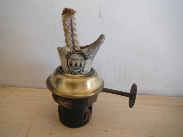

Hi all, just bought this lamp in an antiques market and I am unsure of its exact use based on its shape and colours etc. Hopefully someone can shed some light on it, pardon the pun... :rolleyes:

Thank you for your replies, it does have BR stamped onto it on the inside so unless someone has done that to right it off as being a railway lamp, I assume it is something to do with the railways, just what exactly I dont know.
I was also confused as to why it doesn't have a magnified lense on it. In regards to being flimsy, it is actually very solid and rather heavy...

Doesn't quite match anything in our collection at St Albans South signal box. I wonder if it may be for shunters to use - clips onto belt with the reflected light shining forwards for reading destination labels on wagons, the red and white aspects being used to give signals to train drivers, guards or other shunters.
BR usually marked the external casing in some way, so possibly the BR on the burner indicates the burner is a later date than the rest of the lamp? And if you want to try lighting it, the wick height needs to be substantially reduced to just a couple of mm/one eighth of an inch above the line of the ceramics - as pictured it will give too big a flame and possibly overheat the lamp.
Regarding lenses, it was generally only tail lamps and signal lamps that had lenses as they needed to be seen from a fair distance away; on hand lamps the angle of view at close range would have been rather limited if lenses were used.
What fuel would you recommend to use in it? Regular lamp oil?

We use good quality paraffin - can't recall the exact grade, but it comes in a 5 litre container; seems to work well. Under no circumstances use any more flammable liquid such as meths, and certainly not petrol or lighter fuel - will burn too vigorously!
From one experience at St Albans, I would suggest you take out the burner and fill the container with water to check for leaks before attempting to fill it with paraffin.

Query for JhR: Does the burner/reflector assembly sit in the base of the lamp or is there a vertical post over which the support for the reflector slides to hold the burner/reflector assembly in place?
The burner slides into place in the base of the lamp in a bracket, and the reflector seems to be permanently attached where it is.

Right, thanks for that. But I have to say that that makes the use of the lamp less clear. I'd return to my previous suggestion (post #8) that it was for a shunter's use - but it's like nothing that I've seen before!

Is it possible that this is a non-railway lamp, repaired/restored with non-authentic parts salvaged from a (different sort of) railway lamp?
Quite possible but I can't be definitive about this.

my guess would be a lamp from a horse drawn carriage, restored with a burner from a 1950's railway lamp

and here's the same burner for sale, dates from the 1950s
