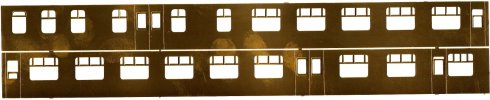

All are Stanier coaches except the first and seventh.
The leading coach is LMS Period 1 Third Corridor (dia 1695): it's of Midland design; corridor side visible.
The seventh coach I cannot discern if it is a Period 1 or early Period 2 Third.
The rest are "classic Stanier" Period 3 - and the TKs and CKs appear to be the earlier diagrams (TK dia 1899, CK dia 1925 and 1969). The later diagram thirds had 2 intermediate doors on the corridor side and the lavatory windows didn't open.
(13th June): Edit - kudos to @John Palmer for spotting the P3 Restaurant Third (dia 1901 / 1923)
So: typical early to mid-1930s stock, before the later TK + CK diagrams arrived on the scene. With post #34's insight on the Scot class's tender swaps, this dates the photo to 1936+.

I'm sticking my neck out because accurate carriage identification is difficult with foreshortened views such as this, but I suggest that the fourth vehicle may be a 68' Stanier RT to Diagram 1901 or 1923 (a total of 34 such vehicles constructed between 1933 and 1937). I'm basing that on window layout, footboard positions and what appears to be a double door offset to the right of the vehicle's centre with ventilator bonnets above each door of the pair. I could well be wrong...
That's a really good spot. I'd thought it looked like a 62' BCK; but, yes, it matches dia 1901/1923, the kitchen-corridor side (example attached for those who aren't familiar).
The use of an RT, makes me wonder if the fifth coach is an Open First?
Thank goodness for Stanier's degree of standardisation in his carriage designs. Unlike the myriad of diagrams - and variations within them - farther east. :D

This is an even bigger reach than my RT identification, but my analysis of the fifth vehicle is along the following lines:
  • High probability the train includes some First class accommodation, so the dining vehicle paired with the RT (if such it is) must either be a First or a Composite;
  • It's likely that this limits to the choice to a RFO to Diagram 1902, or an FO to Diagram 1917, or a CO to Diagram 1903;
  • Door ventilator bonnets appear to be spaced inboard from both ends of the vehicle, suggesting that the vehicle has lavatories and luggage racks at both ends. That would exclude the Diagram 1917 design, which had loo+racks at one end only;
  • I may be imagining this, but I think that the nearer group of longlights on the vehicle are spaced further apart than those at the opposite end. If so, that would argue for a Composite rather than a First, on which the longlight spacing is constant over the whole length;
  • That leaves the Diagram 1903 CO (or the dimensionally identical singleton to Diagram 1984) as the only remaining candidate. The LMS didn't build RCOs but were content to employ the Diagram 1903s as diners. Notwithstanding that the seating bays in the First class section were a commodious one foot longer than those in the Third, these carriages are said to have been fitted internally with detachable class boards, so making it feasible to operate them as full Thirds or full Firsts rather than mixed class vehicles if circumstances required.
Hope this isn't too liberal interpretation of the OP's question “what's going on here?” but these days I find the formation as interesting as the motive power. Feel free to shoot down my tendentious conclusions!
