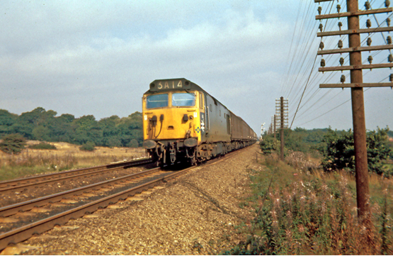

Someone asked a question about Class 50 reliability on a closed thread here. This article may be of interest.
