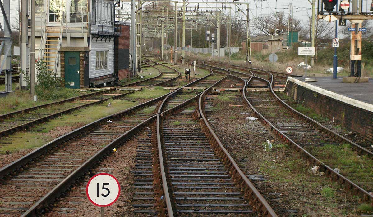

The signalling is pretty ancient, but pulleys would imply semaphore which I don't think still exist(ed) here. Although as it actually says "pullies", perhaps it just means the signaller had to wear a warm jumper as the box was so draughty.
GB
16 Nov 2008
6,468
Somewhere
There was at least one shunt disc remaining and I am sure there were points that were operated by cable and pullies.
LowLevel
26 Oct 2013
8,197
There were various semaphore signals, associated with the sidings I believe.
Islineclear3_1
24 Apr 2014
6,138
PTSO or platform depending on the weather
Actually, there were several ground shunt signals and a semaphore controlling exit to the main line
All now gone of course
