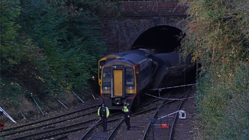

GWR train (1F30 17:08 Portsmouth Harbour to Bristol Temple Meads) passed Dean (on the Down Dean line) at about 13:35, and approached the junction (Tunnel Junction), but for some reason stopped over the junction on the Down Main, with the rear part still on the junction, but with the front part in the tunnel. The front part does not look to be derailed in the photos.
The front part of the GWR train looks derailed in this photo. The flange appears to be to the left (from the camera viewpoint) of the rail. While this could have happened during the collision, I'd have expected it to have derailed to the right (towards the tunnel wall) if it happened then, as that's the direction the 159 will have been forcing it.

another question is how the GWR split on the coupler,
d98489d4-3e86-404a-8493-bae4016f6408-jpeg.104955
that is the front of the back half of the GWR unit on the right.
my question is how the front half ended up further along
Possibly pivoted if the rear wheel of that bogie was pushed the other way?

The GWR train was a 4 car 158 (158762+763)
The SWR train was a 3 car 159 (159102)
Is there a source for this, other than this thread? From the available photos, it shows that the rear of the SWR train is sticking out roughly 1 carriage further than the GWR train, the 3 visible SWR carriages are all still coupled or at least together, and the front of the 2 trains are roughly level.
This indicates that the SWR train is 1 carriage longer than the GWR train. 158763 and 159102 numbers are both visible, which would indicate that unless there's another SWR unit in front of 159102 (3-car), then the GWR train is just 158763 (2-car) and not 158762.
According to #485 the GWR train has split and the front unit is in front of the photographed cabs.
The GWR shown is the rear unit of the 2 units.
159’s can’t be 4 cars. All 159s are 3 car.
