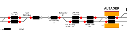

except that ROF Radway Green is several miles beyond the end of the single-track section (and hasn't had a siding for decades), so completely irrelevant.
Railsigns
15 Feb 2010
2,753
except that ROF Radway Green is several miles beyond the end of the single-track section, so irrelevant.
The connection into the sidings was less than one mile from the end of the single line. Regardless of the distance, a crossover was avoided.
