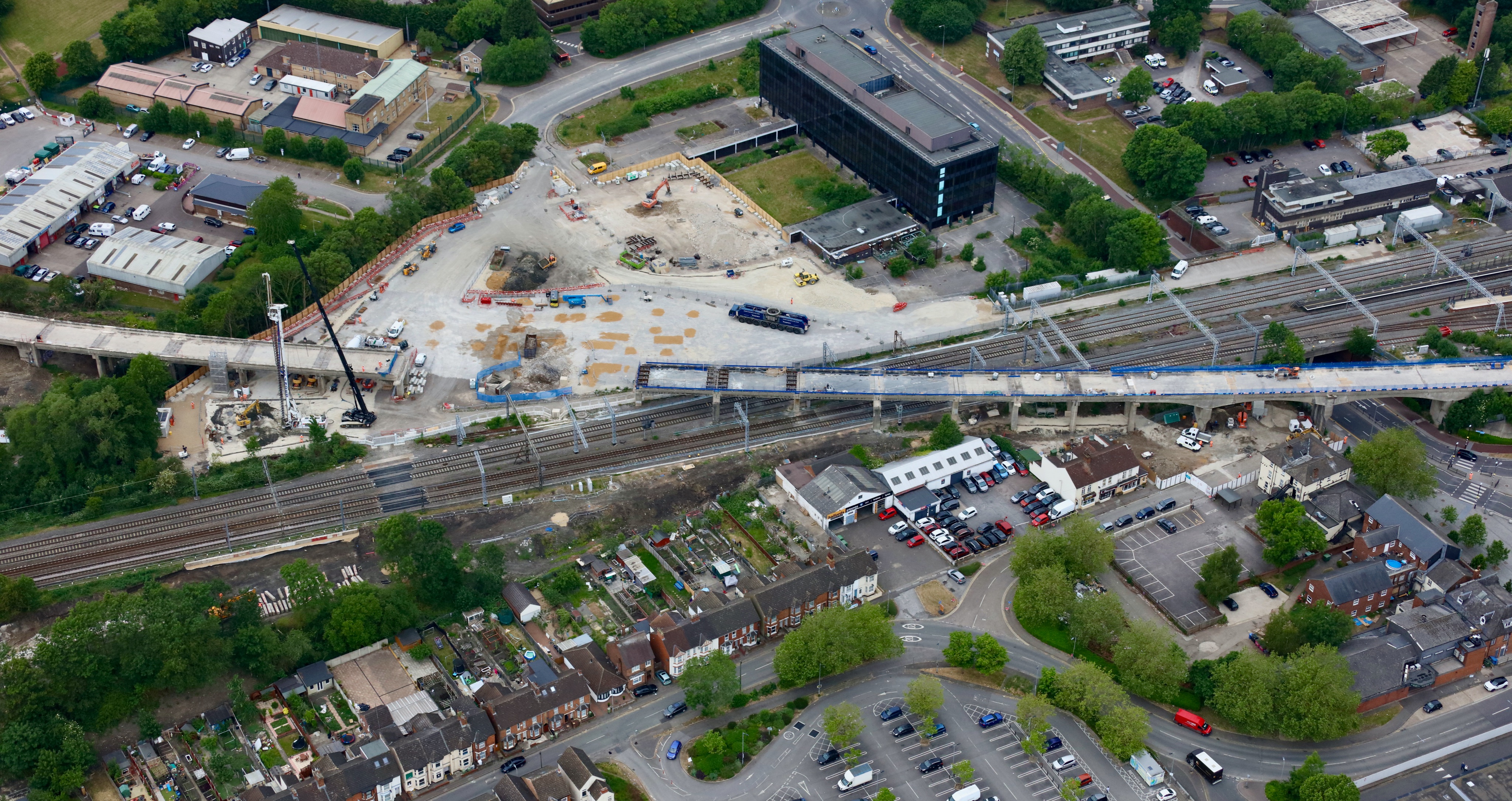

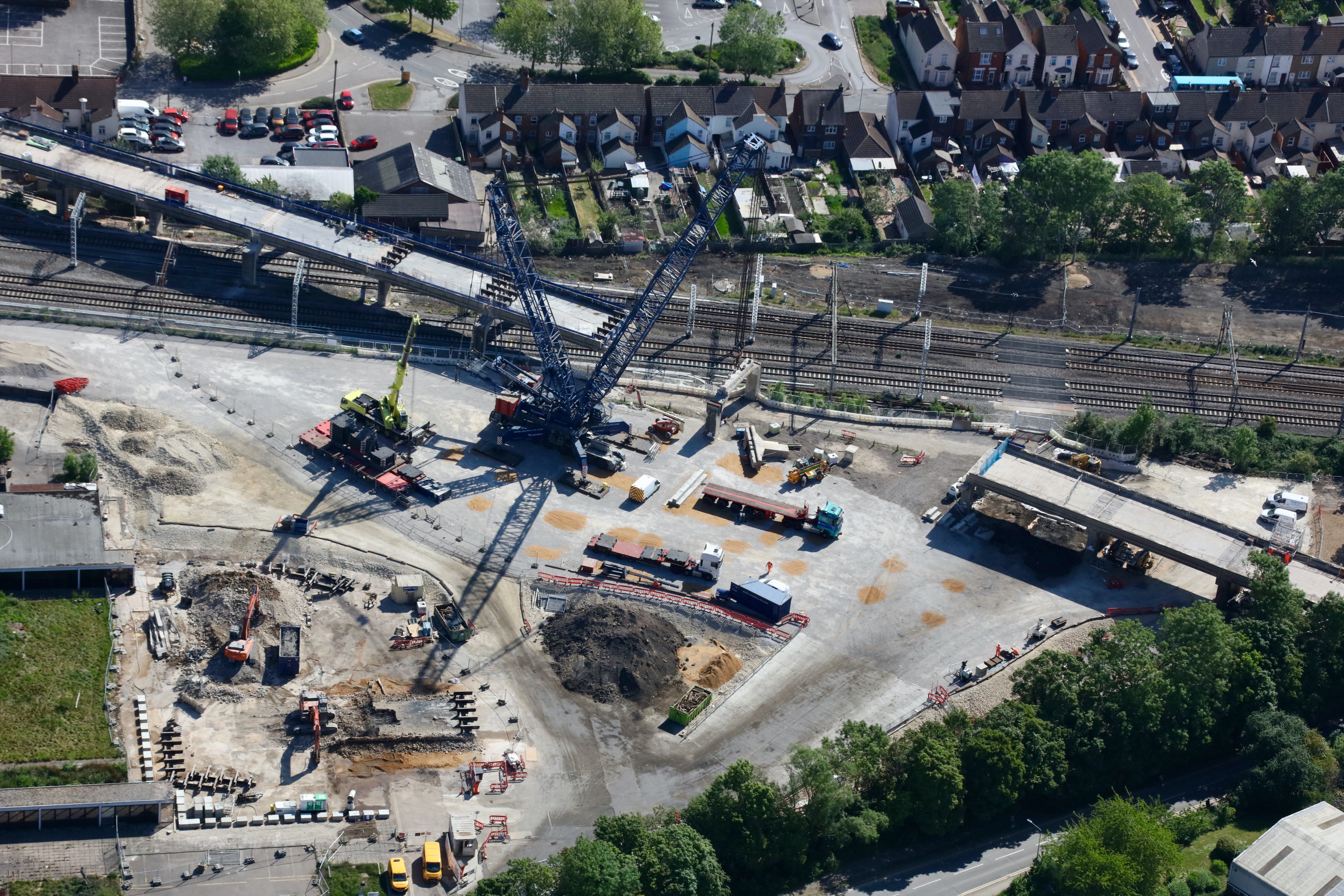

I was wondering if they’ll rationalise the various bespoke OHLE gantries in the vicinity of the existing flyover while they have access? Presumably “normal” four track portals would be stronger and more reliable in the long term?
The Planner
15 Apr 2008
15,985
Surely every Saturday night - Sunday morning there is an effective overnight blockade? The first trains were replaced by buses so I suspected something was going on. May take a wander down later to see!
There is, but the all line opportunity is not big enough to do anything meaningful as you only get 0130 - 0615 Sunday.
24,930
There was some work a while ago to provide new structures underneath the flyover, as I think the OLE was previously attached to the flyover itself. Rationalising the rest isn't on the critical path and can be done as and when, if indeed it is needed at all.
31,447
Ok thanks, so they‘ve already made some changes. Of course once the new flyover is complete they could possibly even revert to attaching to the flyover deck if required.

The new and most of the old structures are visible in the twitter pics linked above, several of the new structures still not in use (non SPS).
31,447
Ok thanks for that note, I’ll try and look at them at a decent size...
OLE works to date have broadly been installation of new OLE foundations/structures in the cess, 10ft and wideway, re-registering of catenary system and removal of redundant OLE structures. The new OLE structures are clearly identifiable in the twitter photos - being light grey, whilst the old ones of brown/darker grey.
The new BFO portal structure beams will be installed in-between the OLE structures. Then stove pipes will be attached between the new portal structure beams to allow the OLE to be re-registered to it's final position, at which stage the OLE structures within the footprint of the BFO portal structure can be removed and the gaps between beams filled with the remaining portal structure beams.
The result will be all ground mounted OLE removed within the BFO portal structure footprint, leaving the OLE system mounted from stove pipes attached to the underside of the BFO portal structure deck.

https://twitter.com/nrairops/status/1265204798305054726 has some more aerial photos of the Bletchley flyover, from Network Rail Aerial Operations, taken on Thursday May 21st
EY7oBdNWkAAcHnX
EY7oBdNXsAEC7Gc
EY7oBdOWAAEC3lz
