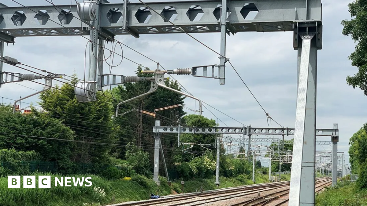

Dismay at government pause to rail electrification​
East Midlands council leaders have said they are dismayed at the government's decision to indefinitely pause the northwards electrification of the Midland Mainline.
The London to Sheffield railway line has been upgraded to take electric trains as far as South Wigston in Leicestershire, but the Department for Transport (DfT) confirmed on Tuesday the further extension of the project was on hold.
A government spending review said funds would be focused on other transport schemes.
