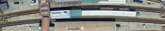

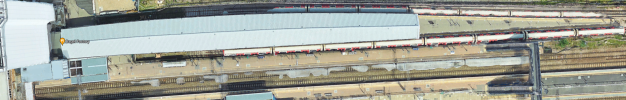

I drew a straight line on Google maps, and found that the line was 50cm further from the platform in the middle than the ends. As the distance is proportional to the length of the chord squared (for small gaps relative to length), I estimated for a single carriage it would be about a cm
Probably should measure next time I’m there
