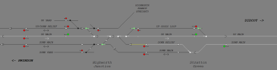

Old maps and the pictures seem to confirm that there were. Whether such platforms could be restored, or whether they would be long enough, is a different question.
My proposal was based on the idea that the Didcot terminator from Paddington could continue to Swindon as well.
The filled in bay at the east end of the surviving island platform couldn't be accessed today as platforms #1 and #3 were extended through its throat area leaving no space for a new turnout to diverge between the converging tracks outside the starting signals. A platform #0 to the north couldn't be accessed from the down main today without a very comprehensive remodelling of the big ladder junction at the east throat (=expensive and disruptive). A solution to that might be to cross local trains over onto a bi-di relief on the north side before that, West of Stratton Green bridge on the eastern approaches. the current four track alignment might be adapted to provide a 'right turn lane' for incoming locals to turn into en route to this bidi relief from Highworth Junction.
Thank you for that @MarkyT
I must confess I was assuming platform 0 only needed to loop off 1 since those two would then perform the function that 1 and 3 do now for up mains.
However, I had missed the fact that the down trains towards Gloucester need to use 3 and not 4. Therefore 3 will still be needed for those and cannot be blocked all the time by terminators from Didcot/Oxford.
IF the down main can access platform 1 then it would be no problem because the down trains to Gloucester can use 1 (as a direct replacement for 3), but that may well need the pointwork you suggest.
Ending up with a lot of work to get a useful platform 0, but maybe worth it given the numbers going between Swindon and Oxford (plus the marginal saving on the fact that Didcot terminators are based just to the East of Swindon)

Is there enough capacity on the Golden Valley line for a second hourly Swindon – Gloucester (/ Cheltenham), and could that be extended any further east? The main problems with extending it to Oxford that I can see are that out of the three main routes west of Swindon it has lowest demand from Oxford and Milton Keynes. It also wouldn't be competitive with road timewise for Oxford – Cheltenham journeys (at least 01:40 by train – maybe slightly less if avoiding Didcot and skipping Kemble, Stroud and Stonehouse – against just under two hours by bus or just over an hour and park & ride time by car).
I think that's why Swindon is the compelling contender because it gives equal access to all trains heading west that stop at Swindon, and while extending to a major interchange, not going so far as to introduce too much extra performance risk. Extending routes needlessly adds complexity and risk as trains encounter more junctions and trains, every one of which adds delay potential. Didn't Central Trains teach us that joining up sprinter diagrams across the country from coast to coast isn't always a good idea. Note The vast majority of trains to and from the west do stop at Swindon. If a new platform #0 was constructed north of the station it might be sensible to plan and safeguard for possible through running in the future with a new track connection direct from the west end (initially buffers) to the Golden Valley, potentially giving an entire new fourth full-length platform and potential for a drastically improved north entrance and passageway or bridge across the station. Such a new long (~270m) side platform might have a shorter (170m) terminal bay platform (#-1 - working title!) along the east part of its rear face. In the meantime, making #0 a through platform from the outset could be challenging if rail access to the logistics warehouse to the north of the station at the west end of the station must be retained (I have no knowledge of traffic status or siding agreements).
I must confess my initial thought was that 0 would be through and therefore have access from the West. Whether the will would be there to allow access from all lines to 0 is another question. However, it looks a fairly straightforward task given London-bound trains can access platform 1 from both the Bristol and Golden Valley directions.
I like the idea of a -1 as well, though that might be pushing it a bit far, especially if 3 can be used for terminators. The advantage of 3 over 0 is that it is in the middle of the formation and should therefore reduce clashes relative to having to wait to get across to 0 when terminating from the Didcot direction.
