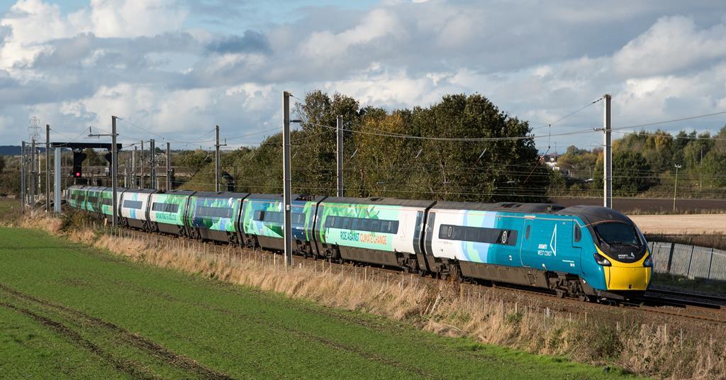

I don't see any sense in tilt to be honest. It looks like it will be possible to get most of the WCML to 125mph without it, and it limits loading gauge, I love how spacious the Avanti 80x are without it after years of tilt profile Voyagers and Pendolinos.
286m is the present length of an 11 car Pendolino, is it not? I would go 300m for a small capacity expansion, it would only need small platform extensions or none at all in some cases where the back could just hang off.
Otherwise this makes a lot of sense. As for the HS2 200m units, TPE is going to need a load of EMUs for its electrification, isn't it, and maybe that length would be good for ScotRail's forthcoming electrified longer distance routes? Or would the cost of changing part of the order to 275 or 300m units be affordable? WMT after all mucked about with the 730 order substantially and it wasn't unaffordable to do so.
11 car Pendolinos are 265m - The additional proposed 21 metres is the capacity extension to suit existing infrastructure limitations at the likes of Glasgow Central and Manchester Piccadilly, and SDO at some intermediate stations.
Ah, of course, I read that as 268 rather than 286 and was thinking about the odd lengths of Pendolino coaches (24 intermediate, 25 end I think).
I'd just go for 300m (12x25m) and deal with the platform issues. That way it can probably be formed out of an adjusted HS2 stock order as that's 25m vehicles.
Overall, this sounds like a sensible proposal to salvage maximum benefit from the residual HS2 route and the planned HS2 train fleet, if it's not possible or cost effective to vary the fleet consist, while tying in with the timescales of Pendolino replacement.
True, though I remain of the view that tilt is not necessary and was a late-1990s fad once 140mph on classic lines had been forgotten about.
