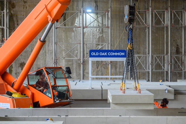

First platforms installed in the old oak common box
I enjoy the mockup station sign. Might seem useless to some here, but helps in some way to convince the public that HS2 is making real progress.
Indeed and it reinforces the suggestion that the project is not going to be ready until the mid 2030's as bizarre.
