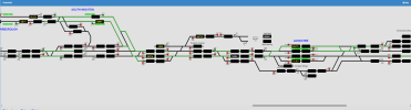

londonmidland
22 Dec 2009
2,098
Leicester
23:00 and plenty of movements going on in the Leicester-Wigston corridor. Hopefully if electrification happens, it won't be too difficult to amend at a later stage, should the Peterborough to Nuneaton lines be independent of the Midland Mainline.
An image of an Open Train Times signalling map within the Leicester area.
