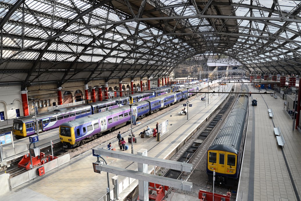

Everywhere north of Crewe (which includes Liverpool) benefits from the authorised sections of HS2.
The Manchester leg, combined with NPR, gets HS infrastructure closer to Liverpool and provides fast trans-Pennine links.
A 400m station in Liverpool for captive HS2 trains would be extremely difficult to engineer, unless it was in one of the disused tunnels from Edge Hill.
Currently, I'd say Bradford has the strongest case to be better served by the current IRP proposals, plus better WCML links north to Scotland if Golborne is to be axed.
Every part of this post is untrue. Including some old myths being repeddled. There are no fewer than 4 central Liverpool sites that have been independently identified as viable and cost effective sites for 400m platforms.
It shows the level of gaslighting that has been going on, that the long standing and expensive rebuttals have had such little attention paid to them.
In fact, the notion of a Liverpool HS2 station needing to be underground was one of the first lies to be uncovered. In similar way that Euston was grossly underestimated to fall within "envelope", a series of nonsense inputs were provided - from "superceded" passenger forecasts, to assertions such as that reiterated above.
Further, it was HS2s own reports (attempted suppress) that confirmed what we already knew: HS2 as is would be economically damaging to our city.
So you don't think HS2 to Crewe benefits Liverpool at all?
How is it disadvantaged compared to other places north of Crewe?
It will benefit to the same extent as any other station on the WCML north of Crewe, all to be served by 200m trains in current platforms.
When were these 400m stations announced given that the first meeting about 400m station options was reported in December 2020:
The commission, which met for the first time this week, comprises a range of experts from across transport, business and the public sector.
With this report from September 2021 confirming that the commission was still yet to report:
The commission is chaired by Everton CEO, Denise Barrett-Baxendale who outlined the importance of the project to the whole area: “The city region is faced with the momentous task of rebuilding its economy after the pandemic. This project is exactly what is needed to boost the region and bring much needed jobs and prosperity to the area, something I am extremely passionate about.” No date has yet been announced for the commission to report. That leaves scope for speculation
