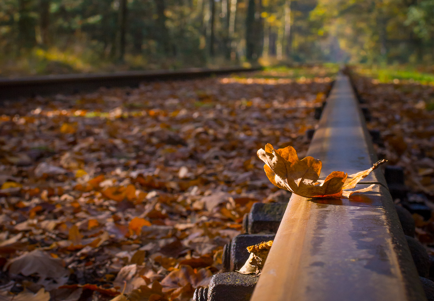

Rail Engineer has often written about the problems of low adhesion caused by, inter alia, leaf debris rolled into the railhead. As a reminder, dry leaf debris can cause wrong-side track circuit failures and, when wet, can lead to very low wheel-rail friction levels.
A coefficient of friction of approximately 0.2 will allow trains to brake normally, but wet leaf debris firmly rolled into the rail can deliver an exceptionally low coefficient of friction in the order of 0.01. To put this in context, the coefficient of friction in a well-lubricated car engine is circa 0.05.
Every Autumn, Network Rail runs Rail Head Treatment Trains (RHTT) to clean leaf debris from the rails. These trains blast the leaf debris, which by now has been firmly rolled onto the rail head by passing trains, with water jets at between 1,000 and 1,500 bar and then deposit sandite – sand with some ground metallic material suspended in a sticky paste. These trains carry a very large quantity of water and sandite, are very effective, but also use capacity on the network.
