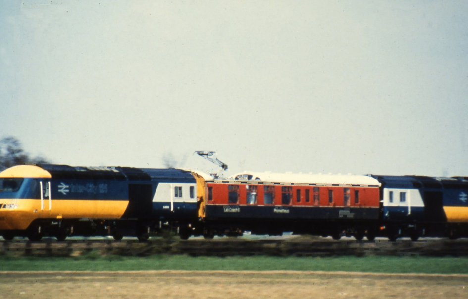

This page is quite comprehensive, from AEI to Stone Faiveley (still in use on many BR EMUs) to the Brecknell Willis/BR high speed pantograph on use on most current EMUs.
http://www.traintesting.com/Highspeed_pan.htm
Intresting site, and an early IEP prototype :)
29,092
Well not really as the panto wasn't supplying traction power ;) Though that will have been a fun formation to drive, lots of power on tap with two HST power cars basically back to back <D
