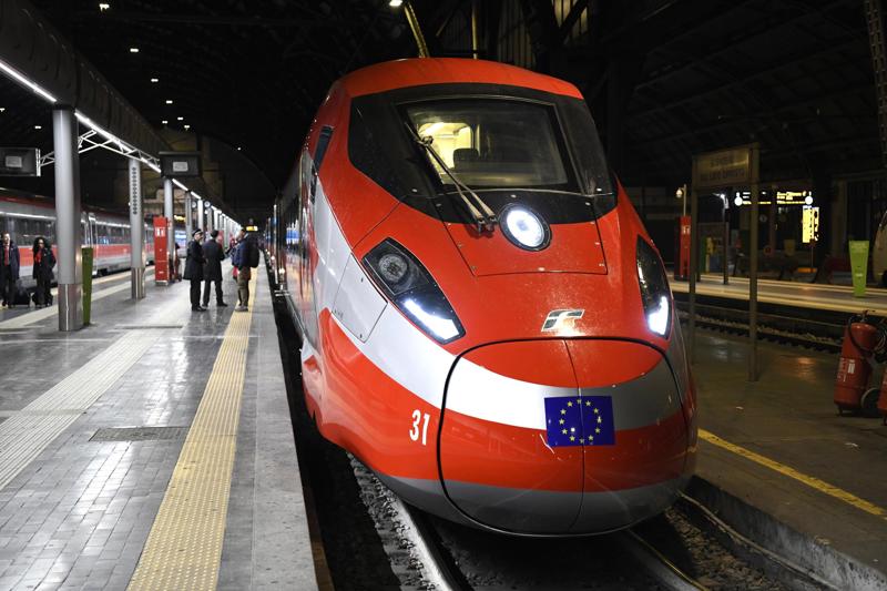

FS Italiane Group (FS Group) has applied to use Temple Mills International Depot (TMI) as part of its plans to introduce new cross-channel services.
The group which operates under the Trenitalia brand in Europe and already runs high-speed services in Italy and France, submitted a bid to link London and Paris in April – hoping to begin services in December 2029. It has joined bids by Evolyn, Gemini Trains and Virgin in wanting to rival Eurostar. However, at the time of the initial application, it was unclear as to whether it would be planning on stabling at TMI.
FS getting on with things. As many others have said, given they have trains on the way already they look to have taken the No. 1 spot on the rankings of viable contenders, although it remains to be seen what the ORR will say about any of these.
Given that FS already operate to Paris (albeit the other side at Gare du Lyon) do they stand a better chance of getting off the ground? They presumably have some maintenance capacity in the Paris area as well as whatever they could get hold of at TMI.
Of course, they are the only contender that is proven, they already have experience running on French network...
