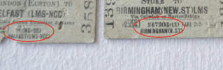

Thank you all once again.
I've done a quick mock up. Any pointers would be greatly received.
Can anybody tell me what the numbers are at the bottom of the ticket? - circled red in the attached image.
Many thanks.

Taunton
1 Aug 2013
11,113
Good start.
"LONDON (Euston)" rather than "Euston"
L. M. & S. R. fully punctuated
"For Conditions See Over" rather than "Notices"
I think the numbers at the bottom are the batch/print machine number, to aid reordering. The individual serial numbers are the large ones on each side.
The special letterpress equipment was latterly consolidated at a British Rail print shop in Crewe, when they finally closed that down in quite recent times, in favour of more modern tickets, the equipment was given away to one of the enthusiast heritage railways (which one?), who now print old-style tickets for all the other heritage railways.

Taunton
1 Aug 2013
11,113
Very good. Can you get the buff colour of the cardboard?
Is the printing on the ticket to be in shot?

One thought I've had is - at that time (1940s or before), to what extent would tickets have been bought in advance - even for such long journeys? The impression I have is that a high proportion - perhaps even most - would have been bought and issued at Euston, on day of travel. But I could be wrong.
