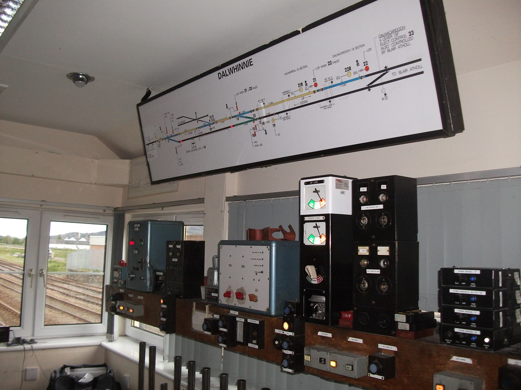

As the report mentions point machines, I assume motor operated points?
As you can see from the first picture the crossover points concerned are No 13 points and the diagram indicate a Facing Point Lock (FPL) that is not separate to the points themselves so that indicates point machines.
The second picture confirms this as the lever No 13 is cut down which indicates powered function and is black (lower) for points and blue upper for FPL.
matchmaker
8 Mar 2009
1,512
Central Scotland
Thanks.
