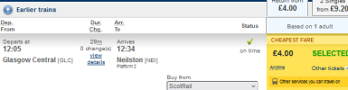

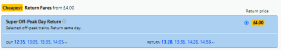

Glasgow to Neilston Day Returns:
BRFares suggests there exists a Super Off-Peak Day Return at £4
National Rail Enquires also gives a £4 option but says its an "Anytime" ticket!
ScotRail offers a Super Off-Peak Day Return at £4
I cannot find it on Avanti West Coast - the cheapest ticket offered is £5 which is the Off-Peak Day Return.
I also cannot find it on trainsplit type websites.
(See images)
I have followed the restriction code H4 when entering the times into the systems:

Why is this the case?
